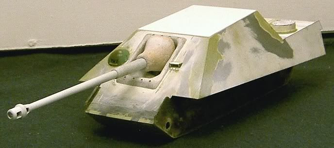

    I'm scratchbuilding a 1/16 RC Jagdpanther
    complete with a BB gun
    I made plans from a 1/35 scale then made a card mock up
  13. JCalhoun
