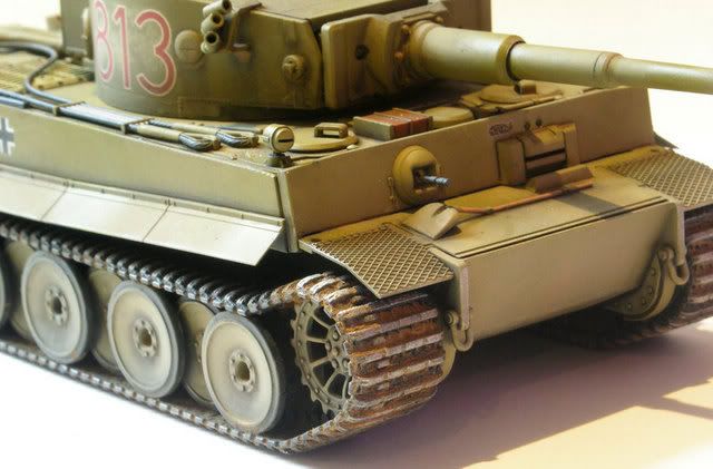

    Be reassured that I hadn't touched a kit for nearly 20 years but after 6 months or so of plastic disasters I began churning out stuff I'm sometimes quite pleased with, the learning curve can be really satisfying, and you can learn a surprising amount about that vehicle in the process:
    (Oh yeah, actual advice: use acrylic/water-based paints to begin with. Far less hassle than oil/enamels. And be sure to check out Missing Lynx.)
