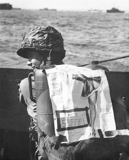

    In relation to the type of flame-thrower to be used in our experiment, there were two different common versions: the American M2 from the Allied inventory, and the German Flammenwerfer 35.
    US Marine Private Kenneth R. Hoger with his pin-up decorated flame-thrower pack, off Iwo Jima, February 1945.
    M2 Flame-thrower (US- First introduced in 1943)
    • Weight: 68lbs
    • Effective Range: 65ft
    • Fuel Capacity: 4 Gallons
    The American M2 was a one-man flame-thrower consisting of two cylindrical fuel tanks containing gasoline.
    On top was a smaller tank that was pressurized and contained non-flammable nitrogen gas or air. A hose connected the nitrogen/air tank to the fuel cylinders. A longer hose led to a nozzle with an ignition system and trigger, used by the operator to fire the weapon.

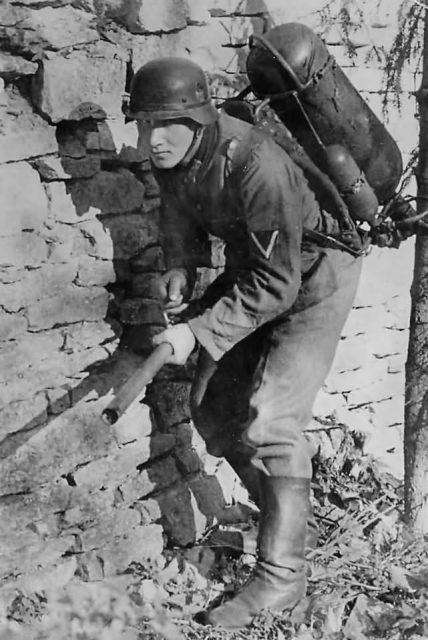

    Flammenwerfer 35 (German- Introduced in 1935)
    • Weight: 79lbs
    • Effective Range: 80ft
    • Gallon: 3 Gallons
    German soldiers with Flammenwerfen 38 in Stalingrad, Soviet Union. Photo: Bundesarchiv, Bild 101I-083-3371-11 / CC-BY-SA 3.0
    The FmW 35 was a one-man German portable flame-thrower. It consisted of a single cylindrical fuel tank containing three gallons of gasoline and tar mix, with a hose and trigger operated nozzle.
    Piggybacked to the fuel tank was the nitrogen propellant in a small pressurized tank. It was significantly heavier than its counterparts, being 11lbs heavier than the American M2 and 22Ilbs heavier than the Japanese Type 93.
    So it had the same basic layout as the American M2 flame-thrower. The propellant was fed into the fuel tanks then the pressurized mixture was forced through a heavy duty hose to an ignition built into a nozzle.
    The operator could then aim at a target and activate the weapon with the trigger.

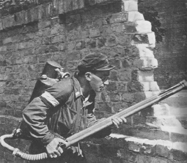

    Resistance fighter armed with a flame-thrower, August 22, 1944.
    But the real danger was from the nitrogen pressurized tank. Though nitrogen is non-combustible, if the tanks were penetrated it would explode much like an aerosol can.
    The force of the explosion and the ensuing shrapnel could easily kill the operator of the flame-thrower.

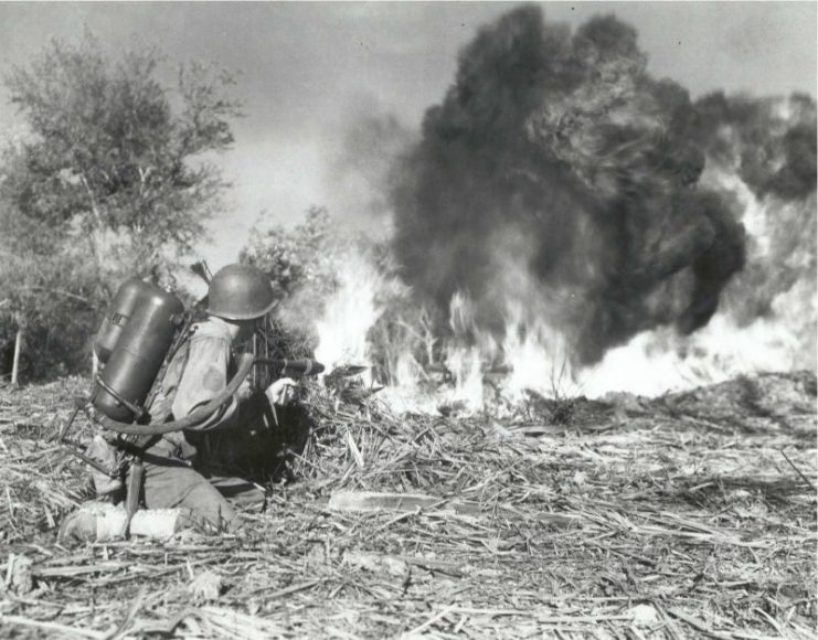

    U.S. Troops using flame-throwers to clear brush.
    But the real danger to the flame-thrower operator was that he had to get within a relatively short range of his target to use his weapon, giving the opposition ample time to shoot at him first.
    What made operators even more vulnerable was that they were slow-moving targets and had to stand up to use their weapon. Operators also found it more difficult to utilise cover due to the nature of the weapon.
