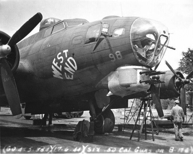

    Personally I think they could have made do with a few fewer guns, reducing weight and drag and allowing them to carry more bombs. B-24 groups often removed the ball turret, sometimes replacing it with a single or twin .50 firing through the hole. Lower waist guns as on the B-26 seem a good option for lower hemisphere defense, especially considering that planes in formation can cover each other. How much of an improvement was the chin turret on the B-17G over the single .50 in the nose* on the -F?
    * some -Fs had twin .50s in the nose, though this does not appear to have been widespread, perhaps a field modification.
