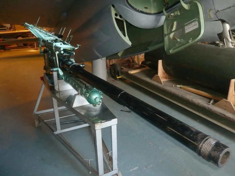

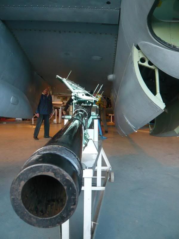

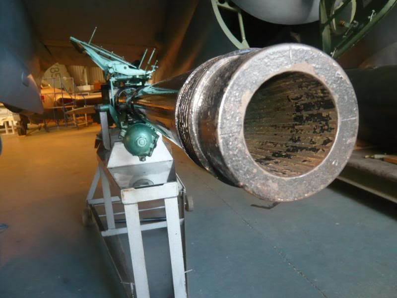

    Up at the Mosquito Museum today, thought I'd take some photos of our Molins 6-Pounder especially for this thread...
    And I thought I'd offer my own comparison of a 6lb projectile with a 0.50cal for comparison...
    Fred Wilson likes this.
  16. gtblackwell
    gtblackwell Member Emeritus
    Jul 4, 2006
    2,271
    678
    Auburn, Alabama, US
    Great post, Martin, I am really curious about the auto loading 57mm. Was the installation in the Mosquito considered a success? Given the size of the cannon and airframe was it possible to reload, what ammunition capacity did it have and lastly are the references of it's use in combat ?
    I presume it was ab anti-ship piece but perhaps it had other uses as well, could one reasonably expect to hit a tank or train ?
    Gaines

    The big blue mosquito book claims it was a success.
    http://www.quarry.ni...o.uk/Molins.htm

  19. Martin Bull
    Hello Gaines
    The installation was considered a reasonable success, given that development had only limited priority. Really, it was intended only for anti-shipping use rather than tanks etc ( as we've discussed before, 'anti tank rockets' etc relied mainly on blast effect rather than pinpoint accuracy ).
    If you can find a copy, I really do recommend getting hold of Des Curtis' book 'A Most Secret Squadron' ( Skitten Books 1995 & 1996, ISBN 9 780952 524700 ).. The author ( who I had the genuine privilege to meet ) was actually there, and tells the whole story of 618 Squadron.and, in the chapter ' New Artillery Of The Sea', describes at first hand the development and use of the 'Molins Gun'.
