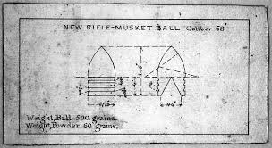

  15. USMCPrice
    Lwd is correct the minie' ball was a huge step forward in range and accuracy.
    As you can see in the above picture it was conical shaped and had a hollow base that expanded upon firing to engage the rifling, thereby imparting spin and increasing range and accuracy. The expanding base also helped seal the bore so more of the propellant gasses could act upon the bullet, imparting greater velocity. It should also be noted that it was not unusual for riflemen to use double and even triple loads of powder for longer range shots. Lwd is also correct that barrel length is a very important factor. I've noticed when shooting mine that humidity/moisture is a big factor in performance. The powder flakes have a tendancy to absorb moisture and it effects burn rate.
    As an aside the most common calibers during the ACW were .58 and .577 for rifled arms and .69 for smooth bores.
