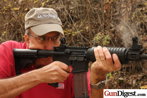

    Actually, no. The heat, gas and carbon are vented completely out of the rifle near the front sight. I've actually installed an Adams Piston System in my M4gery. Most of my shooting is with the cheap eastern European stuff, because... well, it's cheap. Prior to installing the system, the rifle would shut down short of 200 rounds, usually closer to 150 rounds. With the system it never shuts down. When I first installed it, I shot an entire Spam can of Wolf over a couple of sessions - with no cleaning, no oil - just to see how it worked. It never shut down, ever. That was just a test, I don't normally abuse my firearms and I clean them regularly.
    With quality ammo and a squirt of oil now and again, they just run and run. That's why all the operators like Seals, Delta and so on have all gone to piston AR's. The only place that can foul is the vent hole itself and that just works the action a bit harder, which might actually be helpful in a hot rifle. The vent hole can be cleaned with nothing more fancy than a toothpick or a piece of wire.
    You can see the gas being vented in this photo. In a standard M4, that same heat, gas and carbon is venting into the action and chamber. Not a good system.
