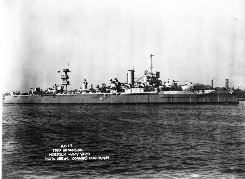

    This is a bit of a stretch, but is it remotely possible you were thinking of this fair lady, USS Wyoming?
    While she is not, in fact, a cruiser, I can certainly see where she could be mistaken for one from some perspectives. And many of her distinguishing features have changed by these two late-war shots. In this slightly earlier shot her battleship heritage is more apparent, but so too is the full scale of her AA armament in her training ship guise.
    And there you have a very slow anti-aircraft cruiser on three times the displacement, more or less. There's a brief discussion including quite a few pictures and some line drawings on World of Warships. Always thought she was an interesting old bird. Her close cousin Mississippi took on a similarly odd demeanor late in life.

    close gentlemen. but those 5-inch guns stick out. i remember open AA mounts, probably 40mm quad and 20mm twins. it might have come during the waning months of the war or even after.
    i'm glad people are as curious as i am, coming four years after i first mentioned it.
